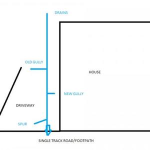

    Possibly awkward driveway project drains/foundations etc
    The drains only serve myself however whilst I take on your points about replacing them the driveway job is a definite DIY one, like everything else because needs must. I'm pretty confident it just needs proper prep, sub base, haunchings, drainage considerations etc. I've got a good noggin for...
    Hi, laying a new block pavor driveway however my house has very shallow foundations and drains. I have put a picture in so you can see the lay of things. The drain is clayware and directly below usual vehicle track and has a capped spur running quite close to the topsoil. So first...
