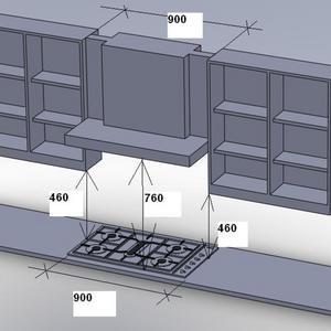

    Gas regulations regarding hob to kitchen wall unit spacing
    Just drew this up to show what seems to be perfectly OK after all. Hob aligns with hood which is 760mm above hob. Wall units are 460mm off the worktop but in line with the hob. I would only need to space items 50mm sideways away from the hob if they are less than 460mm above the hob.
    So according to this bulletin the 50mm either side of the hob does not apply to wall units above 460mm but rather it applies to cabinetry alongside the hob. You need to have anything directly above the gas hob at least 760mm off the worktop but wall units inline with the edge of the hob but...
