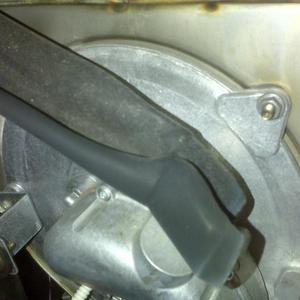

    Vaillent boiler -- air intake pipe melted
    I have had the same problem today, i have the ecomax 828 do you think the cause is the same (sealing failure on the "burn chamber" ) ?? [/img]
