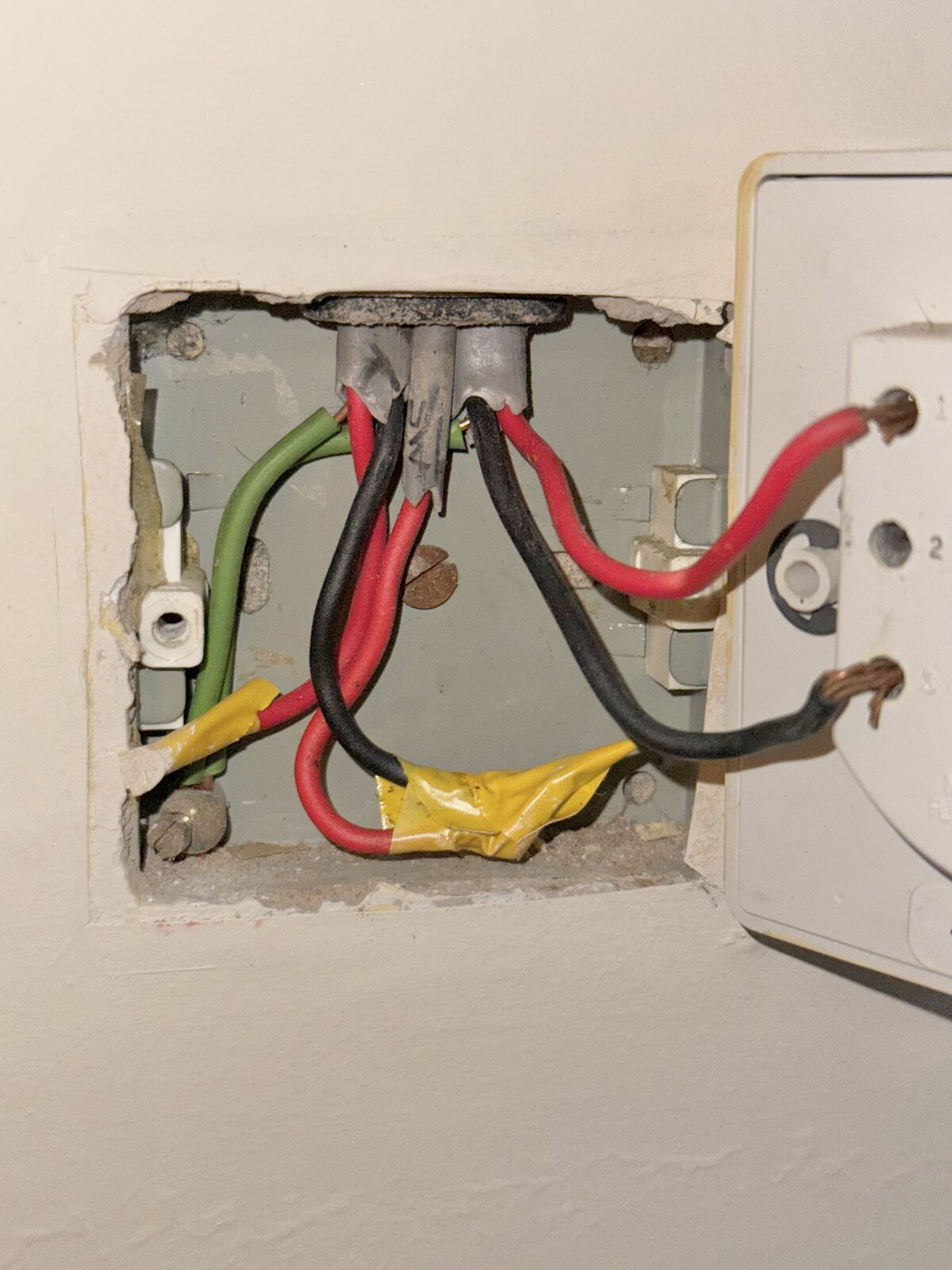

I have a Timeguard ZV210 dusk/dawn switch that I want to convert back to standard on/off single pole switch. But there are 3 cables in the back box and I’m unsure which 2 to attach to the new switch, ideas?
Got really confused with the black and redd taped together. Also one cable marked SW and the other T.

No, the Timeguard device gets constant power from those two wires and then has electronic switch inside to turn on at dusk, with a manual override 'normal' switch on the front

mmm, not another switch, but this may have been a double gang switch before to switch on the hall light as this is by my front door, so the taped up two could be that. doesnt get me any closer, i seem to remember when i did just move the two connected to a switch as suggested in first comment it just blew the switch when i switched it on (and tripped the breaker).

All that is true, but it's still just a switch with two wires.
Buy new switch, connect those two wires to the switch. The end.
Other taped wires are unrelated.

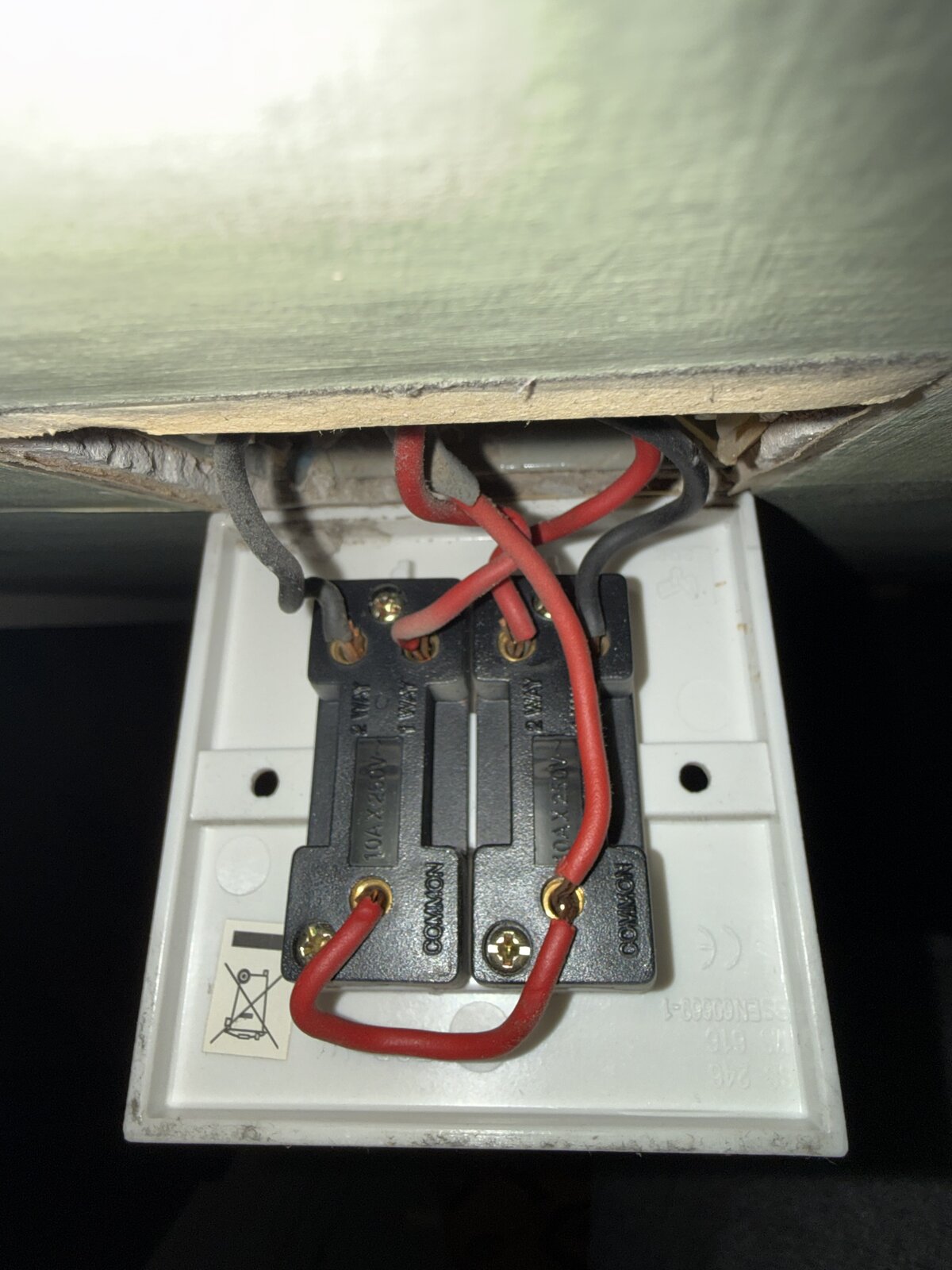

Thanks for the responses chaps, yes it would make sense that this was originally a double switch and I would like to return it to that as well. Currently the hall light is on another double switch at the other end of the room, photo inside that switch below. My thoughts are if I copy that layout it might work?

At the switch in the your original Timeguard picture, if you look at the taped up wires, you have a twin cable with red and black, and a cable with just a red.
To confirm, is the single red and the black from the twin cable joined together?
If so, on one side of your new 2 gang switch, the single red goes to common, and the red and black from the twin cable go to the remaining terminals, probably marked up as L1 and L2.
Markings vary.
On the other side of your new 2 gang switch, for the Timeguard, the red goes in the common, and the black in L1.
