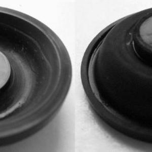

    Where to buy Ideal Standard cistern rubber washers?
    thanks for the correct description - i'll find my local plumbers merchants and buy a pack to replace the rubbers in both cisterns and have some spare tomorrow :)
  6. captain-midnight
    hi forum, Hope someone here can tell me where to buy a pack of Ideal Standard dual flush cistern rubber washers - this is the water inlet control rubber washer which is just like a small diaphram. Not sure I've called it the right thing, but it controls the flow of water into the cistern...
