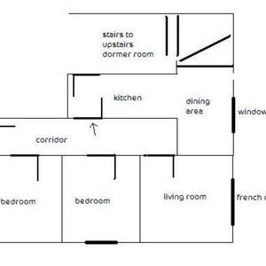

    Removing Kitchen Door - Fire Regs ?
    Hello all - I've searched the forum for this topic but the only thing I can find relates to a block of apartments... however apologies if it's a duplicate. I have a bungalow (floor plan below) with a single dormer bedroom accessed through the kitchen. All the main bedrooms are on the...
