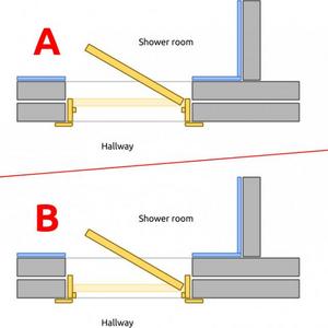

  5. C
    Door lining in thick wall
    Cool, thanks for the advice :)
  6. C
    Ah OK, thanks. So to cover up the rough blocks between the edge of the door lining and the inner wall of the shower room I guess I just dot and dab some plasterboard in place, butted up against the door lining?
  7. C
    I want to fit a door lining into a doorway that's been cut through a double leaf block wall. Ideally I want to hang the door so that it's near enough flush with the entrance hall side of the wall, but opens into the shower room (see picture). Is either layout (A or B) do-able, and if so...
