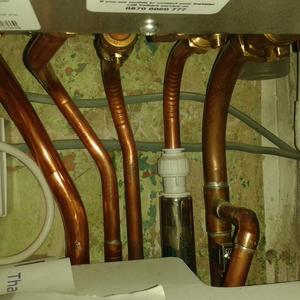

    Refilling Vaillant combi-boiler
    Thanks guys. I managed to shove my whole arm into the ridiculously small space at the back of the cupboard and managed to find the filling loop and repressurise the system by feel. Only problem now is the pipe on the right is dripping where it connects to the boiler. Only once every 5 seconds...
    Thanks for the quick responses. Unfortunately I still can't locate this. The pipes go down and disappear behind the kitchen tiles before re-emerging in a cupboard below, and there's nothing coming off the pipes there. Would the engineer really have located this behind the wall?? The boiler...
    Hi all, First of all, apologies if I should have been able to work this out from other posts, but I've trawled the forum and couldn't find a satisfactory answer. I've got a Vaillant Ecotec Pro 24 which is showing low pressure (0.7 Bar). The underside of the boiler has no filling loop and...
