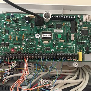

    Texecom Elite 24 - Bellbox Issue and Teething Problems
    Hi Its all that I had at the time - I'm presuming it shouldn't make any difference or have a detrimental affect on the system? Thanks
    Hi all Just an update - received a replacement backplate from the supplier on friday, fitted the new one and it works a treat - LEDs now flahsing slowly alternate to indicate normal operation. Ive also got the SMS text thing working, however it seems to send 2 SMS every time there is an...
    Yes I know what you mean - i find it strange too. I cant think of anything else i can check - voltage is fine 13.60v, jumper is set to SAB, Low current mode disabled, and makes no difference whether battery jumper is set to on or off. bell test at keypad works fine, strobe test at keypad works...
    The left LED is still working, but right one is not. The speed of the flashing changes (as it should) when the tamper is down compared to when the tamper is up, but no matter what I do, the right LED wont flash - only the left one works. The bellbox seems to work fine apart from that. I'm up...
    Ah sorry I was looking for it in Wintex - Ill do a test call from the panel and let you know. I know the panels maybe set to SCB as default, but in case i may have changed a setting on the panel with regard to SCB / SAB I just wanted to check - but didnt know where to find it. Or are you saying...
    Hi Secure Is SAM mode the same as SAB? I have the jumper set to SAB on bell box but unsure on my settings at panel end - where do I find this? Those 2 green dots next to Bell SCB when i did the diagnostic (see pic in my other reply) just threw me a bit - have I got my panel set to SCB yet me...
    Hi chaps thanks for your reply I have now removed the 2k2 resistor in the box. I have checked the voltage at the bellbox and it is a healthy 13.6v. I then checked where the LEDs plug in as you suggest, all seemed ok. I even swapped the two LEDs over to see if the fault followed the LED or...
    Hi all Please go easy on me - first post here, although have been reading various posts on the forum which have helped me to install my Texecom Elite Premier 24. I have (just about) completed the install, but have a few questions on commissioning and setup before i put the lid on it and forget...
