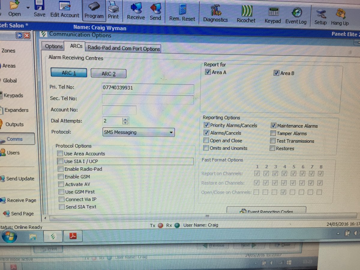

In terms of the communicator I have ticked the box for SIA text and only got Alarms/Cancels, Priority Alarms/Cancels and Maintainance checked and entered my phone number. I will set the alarm off and see if it sends me an SMS. Im only interested in it letting me know if there has been an intruder - not bothered about whether its armed or not etc.

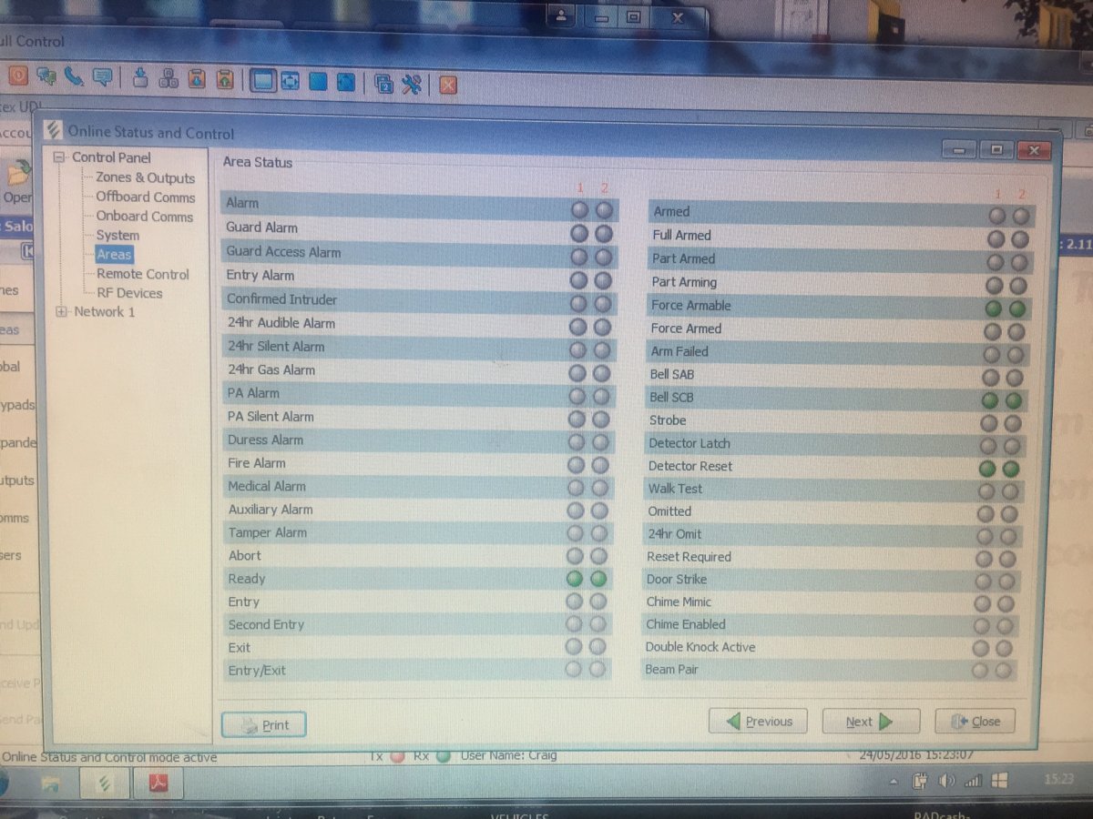

If I click into diagnostics, i notice the two green dots next to "Bell SCB" is this right? I want them set up as SAB, (I think?) and I have set the bellbox jumper to SAB (as it comes as standard.) Do I need to alter a setting somewhere - could that be causing my bell box LED problem? Pic attached of diagnostic screen.

SMS messaging requires arc to be set to SMS, SIA Text is not required in the config options at the end.

Not sure about your bell, poss faulty. Batt link should be on. Low current mode does not really matter if only one bell. SAB link should be on & same setting in panel.

Is SAM mode the same as SAB? I have the jumper set to SAB on bell box but unsure on my settings at panel end - where do I find this? Those 2 green dots next to Bell SCB when i did the diagnostic (see pic in my other reply) just threw me a bit - have I got my panel set to SCB yet me bellbox to SAB? Where do I check/change this?

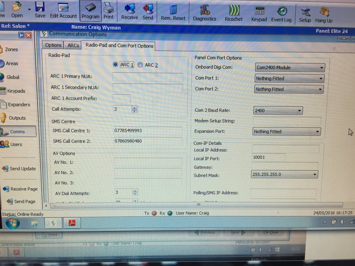

In communication options, ARC1 SMS call centre 1 number is set to 07785499993 and SMS centre 2 is set to 07860980480, do these need changing to use the Vodafone 20p option as you talked about? Under the ARCs tab, i have entered my mobile number in primary tel number. I am struggling to find where to perform a test call 0 also?
Thanks a lot I appreciate your time - ive attached another 2 screen shots of SMS settings.

sorry sab cant type for toffee hands been decorating, the panel and the bell are at default SAB
first number is Vodafone the second number no longer exists hasn't done for years, no idea why its been left in.
