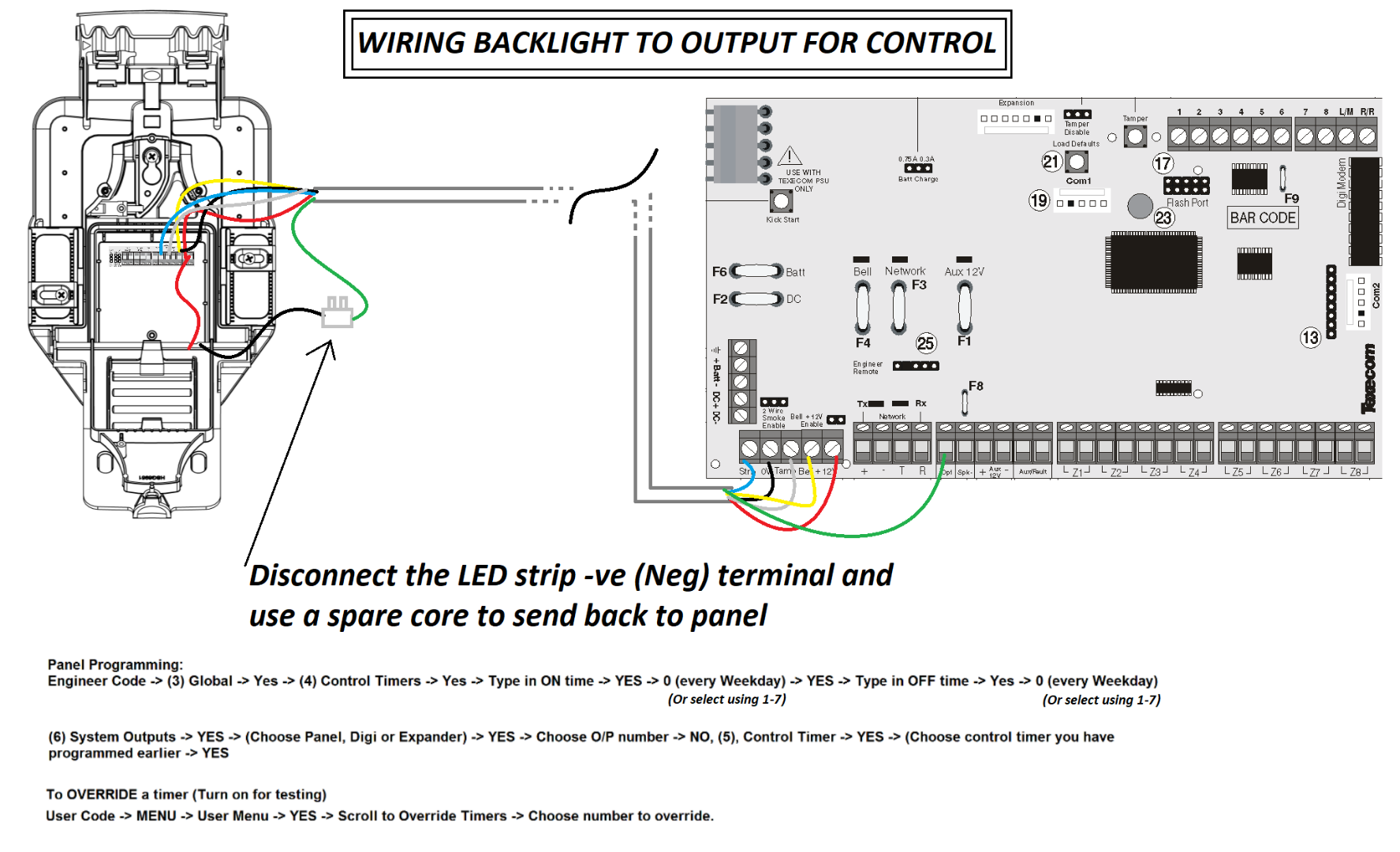

In terms of the backlight on the Odyssey X-B. Is there a way to have the backlight on when the bell box is in normal operation but then flash or switch off when the bell box goes off?
what colour lens?
the back light on the odyssey X is wired to 12V and 0V at default, you literally wire one leg to an output and have a custom out output.
Need to know what panel its going on.
for example all orisec and Texecom elite panels you can program an output up, on other panels like the Excel or R8 this wont be possible, however, you should be able to use the positive or negative leg of the back light going to the strobe terminal to acheive on all the time and flash when activated.

The back light can be wired to the strobe output of the panel and or an output and use chains wrt to the orisec panels and custom outputs on Texecom panels and similar applies to most of the other more sophisticated panels.
To have the backlight switch off on the Odyssey X-B when the bell box is going off, Texecom Tech Support adwised me to wire the backlight as shown in the following wiring diagram below.
Tech Support advised me to ignore using Control Timer when programming the output and instead set the output to Alarm. Tech Support said this should then switch off the backlight when the external sounder is going off.
Note. I have not tested this as of yet, so not sure whether it will work and I don't use Texecom panels.
