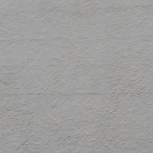

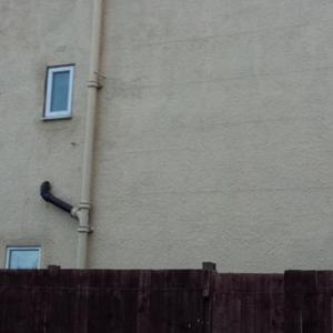

    Thanks for the replies. Am grateful. Will go for a survey then. Like the house but me thinks it'll all depend on the cost to resolve the issue. Thanks again, Daren

    Cavity wall tie failure or render joints.
    Hi, Can anyone offer their opinion on these photos and whether the horizontal lines are cavity wall tie failure or joints In the render as they've moved up the side of the house? I'm no expert but hoping to get an indication and whether to go for a survey. The property was built mid...
