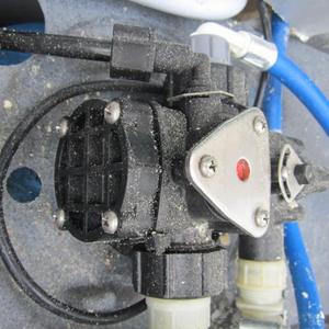

  9. D
    Monarch PS11 Water Softener
    As you can see, it doesn't have a timer on top, its the previous version. I suspect that no power is going to the regenerator, hence no recycling in the evening. Any idea where I can start to diagnose this. With reference to the 6 months, this unit was one that my mum and dad didn't want...
  10. D
    All, I always come back to this forum for help and have found you guys extremely useful in the past. About 6 months ago I had a water softener installed outside my kitchen, which I have since boxed and insulated. In the last week I have noticed that we do not have soft water in the...
