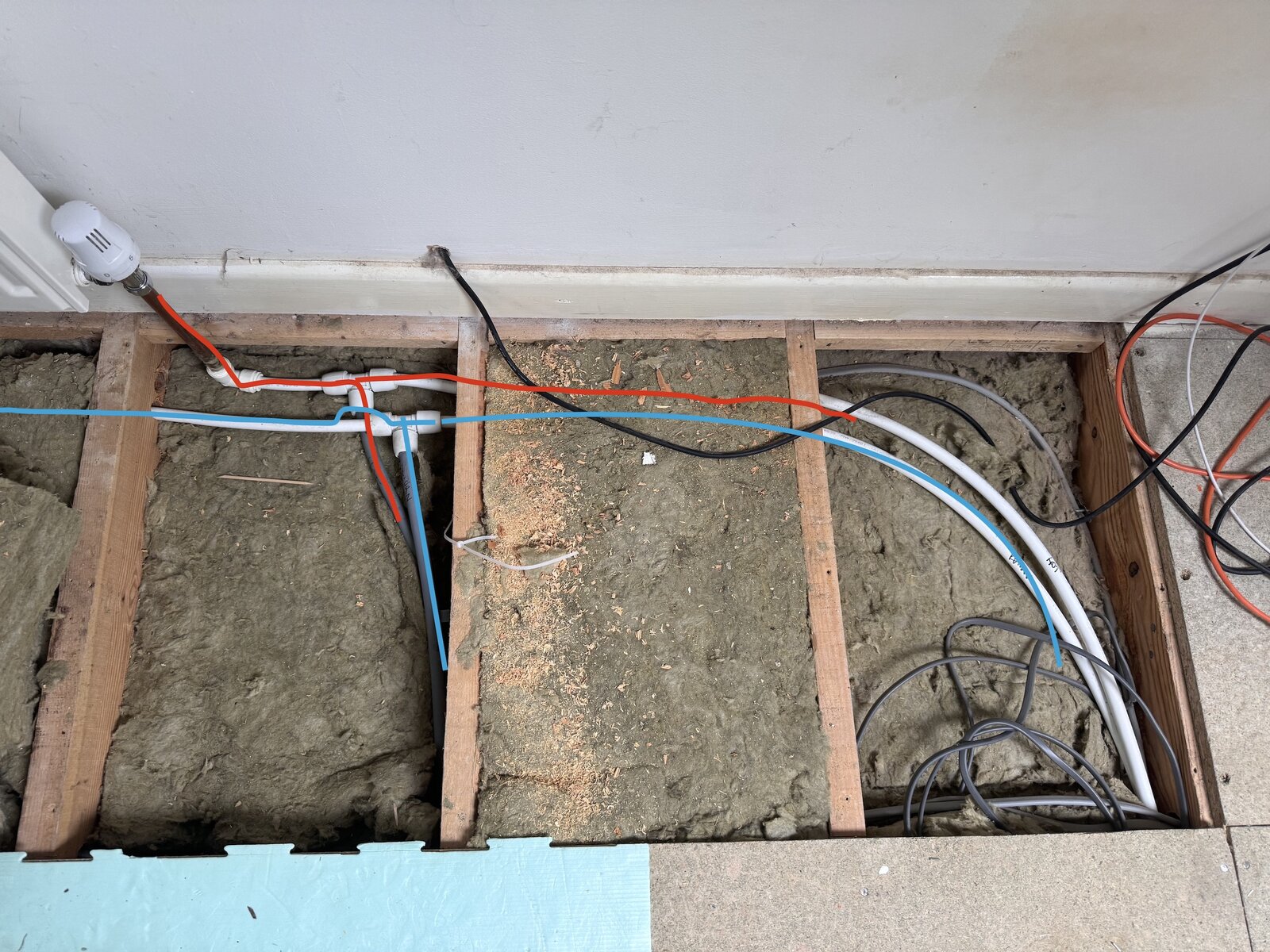

Ok,
I have lifted the floor, before flushing or doing anything in the system. In the picture attached you can see the radiator in the room (top left, with the TRV on the flow side marked in red). This flow comes from "somewhere" else in the house. However, when the system is on, the pipe gets hot, so I assume that this is correct for flow.
On the left hand side of this radiator is the return (marked in blue), which doesn't get hot obviously and flows back to somewhere else in the house. Please note, all other rads in the house work as expected.
The pipes that go off to the right of the picture, red labelled as flow, blue labelled as return go to a downstairs radiator, which the flow pipe doesn't get hot. Luke warm, if I turn off this radiator and stop all flow to it.
If on the downstairs radiator I close both lockshield and TRV, then "some" warmth can be felt on the radiator in the picture, the flow pipe is hot, however, the return makes no sound and doesn't even get warm. Hence I am thinking some form of blockage.
I suspect the return is blocked or not working at that T-Junction (on both flow and return). Additionally my thoughts are, if there is a T junction close to both radiators, will that potentially conflict with each other? In other words, the flow hitting that from the left and then hitting from the right, so pushing and pulling against each other?
An additional thought, if I block off both of the T junctions (flow and return) and stop waster flowing to the downstairs radiator and see if I get decent flow and return back to this radiator in this room?
Would value your thoughts.
Is the T junction right?!?!?
Thanks,
Doobs

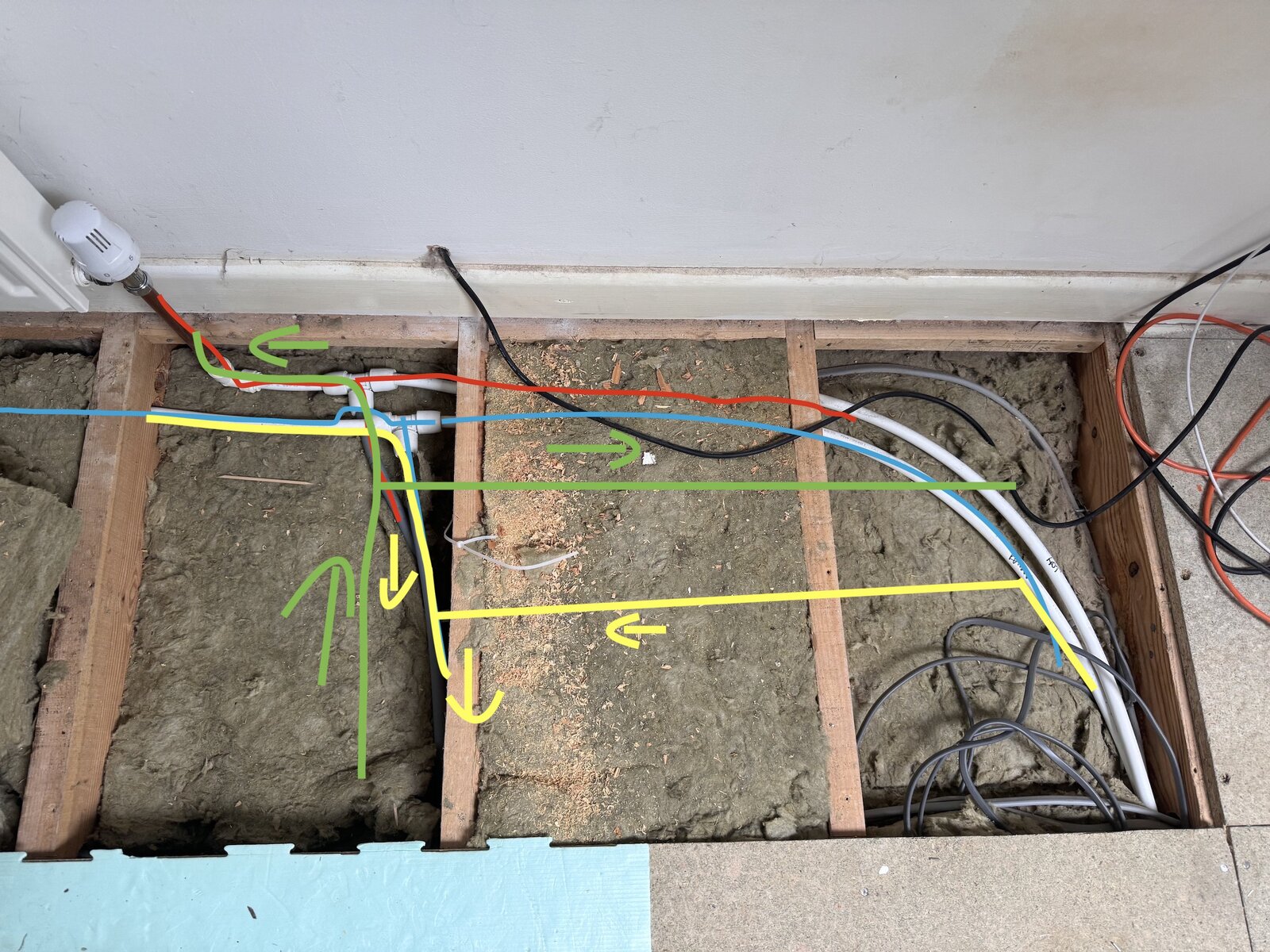

Additional question
Should the pipework be adjusted as per this diagram
With the yellow being the return (moving the T-Junction away from the radiator) and the same with the green being the flow?
That way, in my mind at least, they are not "fighting" each other for flow or return?
