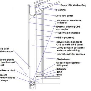

    Sealed or ventilated cavity ?
    The gutter is on the inside so I don't have to take away floorspace for a wall cavity. If I put it external what would be the minimum sufficient cavity width ?
  5. D
    Hi all I am building a SIPS extension and will be cladding it with CPB and render, the cavity will be 120mm wide above which will sit the guttering as this is the best way to maximise floorspace. Here is the section drawing for how I intend to construct the wall The main...
