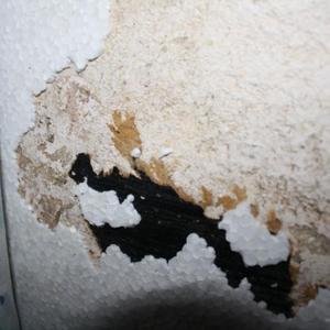

    unidentified black layer on inside of external wall
    thanks for that....another mystery solved!
    Hi all we are in the process of renovating a 1920s cast concrete bungalow which hasnt been worked on for some time. It is throwing up a number of odd things which we havent seen before :roll: Some of the exterior walls are lined with polystyrene under the wall paper which apparently...

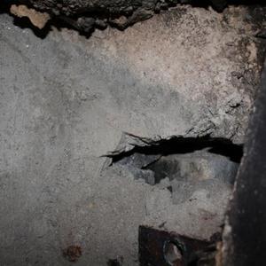

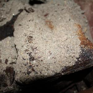

    Also, im still in the dark as to the nature of this loose material behind the back/side plates: im still working on the presumption that it is the insulation material behind the fire plates (presumably once some kind of mortar mix which has disintegrated? but could it be harmful...

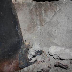

    reinstating an old fireplace
    i have now removed the back plate and the left side plate to reveal a smooth, continuous alcove in which the fire sits: this obviously means i need to repair the void present on the right side: so with this knowledge, the space in which the fire sits is not big enough to open...
  11. D
    i then took off the side plate where the boiler was and this was when i found the cavity and the sandy material began to pour in. The close up shows the cavity a bit closer with loose fill, but its not very clear, im in the process of removing the back plate now which will hopefully improve...
    when i took the back plate off the old cavity was visible where the boiler once was:
