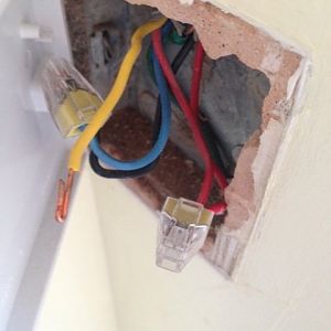

    Hi endecotp I will ensure I terminate all unused wire with wago connectors. Thanks again for your relevant advice.

    Hi, Thanks for the prompt replies the photo is of the modified wiring where I want to put the blanking plate on. I tested the yellow wire with a voltage tester. There was no power going down the wire with the main light switch turned off. When the light was switched on the yellow wire went...

    I asked my Son in law to blank a 2nd switch to our dining room light. When he had completed the job the main switch notwdoes not work. Unfortunately, he did not take a photo of back of the switch. So I cannot go back to the original switch wiring. I have tested the yellow wire and when the 1st...
