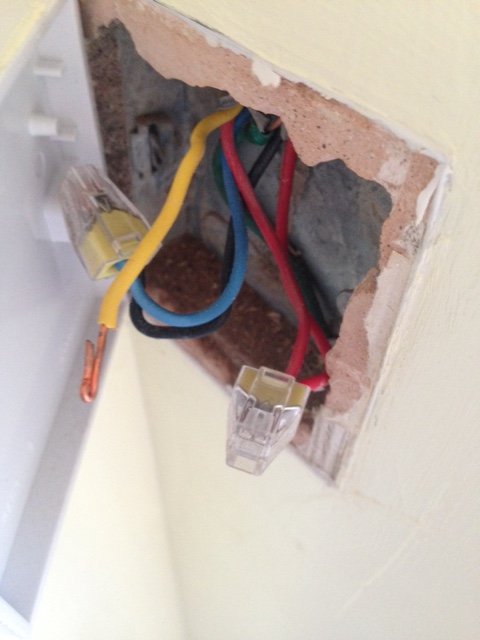

I asked my Son in law to blank a 2nd switch to our dining room light. When he had completed the job the main switch notwdoes not work. Unfortunately, he did not take a photo of back of the switch. So I cannot go back to the original switch wiring. I have tested the yellow wire and when the 1st switch is turned on, it has power. Therefore, my assumption this is the switched live. Should the yellow wire be connected to the 2 live (red) wires. Am I correct?

If you only want that switch to be operative, then ignore the Red,Yellow,Blue cable and just connect the Red and Black from the other cable to the switch.
Am I right in thinking that the photo is of the modified wiring where you now want a blank plate?
Please also post a pic of the wiring at the other switch.
How did you test it?
NO.
I could guess how it should be changed but it would be easier if you post a pic of the other switch, then I (or someone) can give a definitive answer.
If that is the switch to be blanked, then you will have to swap the Yellow and Red of the RYB cable
OR
alter the wiring at the other switch just using the Red and Blue wires and ignore the Yellow.
Safely terminate unused wires.

the photo is of the modified wiring where I want to put the blanking plate on. I tested the yellow wire with a voltage tester. There was no power going down the wire with the main light switch turned off. When the light was switched on the yellow wire went live. I will take a pic of the other switch, but this will take a couple of days.
Surely it could be that Y ans B should be swapped. Hmm, I guess in that case you'd just end up with the other switch the wrong way up.
THIS IS IMPORTANT. Do not leave the unused wire - whichever one it is in the end - exposed as it will be live some of the time! Wrapping it with insulating tape and/or cutting the end off is not really sufficient, it needs to go into a terminal of some sort.

I will ensure I terminate all unused wire with wago connectors. Thanks again for your relevant advice.
