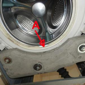

    HOTPOINT WF541 AQUARIUS bad leak, help find it please
    Unfortunately it is not worth replacing the drum in this old machine as I have seen it at £178 plus my time to do it and I suddenly got very busy at work. Then the rest of the machine will still be old, like the seal. Unless the front part of the drum can be replaced which I doubt as it is...
  2. F
    So it is! I thought that the protruding plastic was the welding between 2 parts of the drum. Now the question is, is it worth trying to replace it? seal it to give it a bit more life? Is it going to cost me more than a second hand machine? Where do I get the spare part? Where do I buy the...
  3. F
    Hello, I am completely puzzled as to where the leak in my washing machine is coming from. Lots of water pour out from underneath the machine. Three clues: 1- There were some bits of white plastic (as the plastic the outer drum is made of) last time I took out the wash after flooding the...
