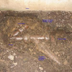

    New Underground Drain
    Thanks for the quick replys. Yes it was the pre formed-plastic inspection chamber I had in mind. When you say grafted on at the low junction, do you mean to cut the clay pipes (one going to the road and one from next door) before the junction and replace both junctions with the inspection...
  9. F
    Hi all, I need to lay a new section of underground drain from the back of my new extension. The purpose of which is to carry rainwater from the downpipe and waste from the kitchen sink. We have a combined rain/waste water drain so that should make things easier. I have excavated the end...
