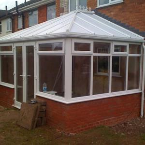

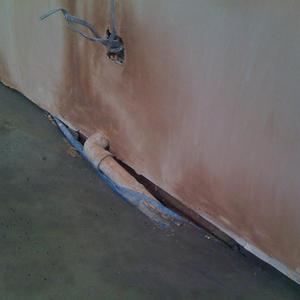

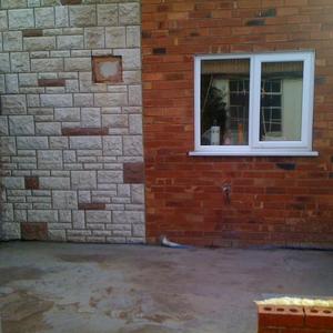

    Drain under a conservatory - problem or not?
    Here are a few images that might hopefully help to illustrate what I'm talking about...
    Just looked at what a gulley trap is - you mean the bit that was built up above the ground that the drain opening sat in? No, they definitely didn't take this out, just covered it up and concreted over it. I've got some photos on my phone from before and during the build, I'll post them up here...
    Hi, this is my first post so thanks in advance for any help you can give me! I'm in the middle of having a conservatory built by a local firm. When the guy came around to do the quote, the one area I highlighted was a drain at the back of the house (where the conservatory is going) which...
