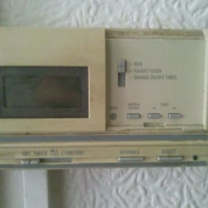

    Just for your info guys. Got a replacement single channel programmer off internet for a few £. Same backplate etc but turned out to have slightly different wiring config. So rather than risk anything I got engineer in ( since i needed hot water boiler looking at also ). Turned out it was...

    Yeah, its single channel timer, wall mounted in kitchen. boiler is in cellar. Boiler-panel by GBL100 posted 20 Sep 2016 at 2:36 PM this is diagram of problem... to be clear. Boiler by GBL100 posted 20 Sep 2016 at 2:35 PM

    The external control panel has definately blown. Its fried inside. That's why I'm assuming that it is the problem. ? Yeah, I tried 1 new fuse in the fusebox when it first went, thinking the fuse was the problem. By the way, I just heard a bang originally, tried new fuse, control panel banged...

    Hello, looking for a little advice for anyone who can help point me in the right direction. My central heating runs from the Vokera. It has 2 electric feeds out. one to a Honeywell froststat, and one to a 3a fusebox, which then feeds to a main wall control in another room. The wall control...
