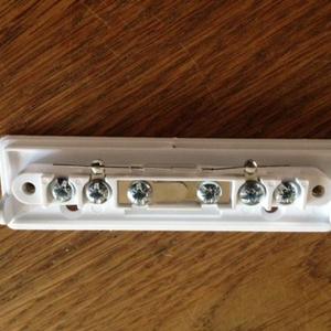

    Surface contacts/PA wiring
    Thanks, as mentioned I've used EOL for my PIR's would you recommend EOL for the surface contact?
  10. G
    The contact that I have has six screws.. Picture of the contact: http://isyn.co.uk/contact.JPG
  11. G
    I'm trying to wire a magnetic surface contact to my texecom 24 alarm system and needed some advice since the packaging was lacking instructions. The contact has 6 connections from which I guess are: 3-4: the inner two are the tamper connections 2-5: the next outer two are wired...
