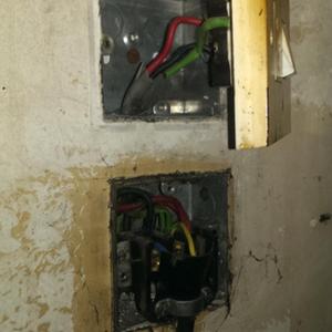

    Cooker hood/hob ignition from cooker socket
    Thanks guys that clears that up then. It will be less than 500mm, just a bit tricky to get a short length of 6mm cable! Thanks again.
  2. G
    Thanks for the reply. There is already a proper cooker connector unit, my apologies for incorrect terminology, I was calling it a bullnose. There is a FCU next to the CCU but it doesn't go anywhere after that, this is where I was planning on taking the feed for a socket to be placed next...

  5. G
    Hi all, Have been reading for a while about this but just want to confirm that what I intend to do is legal and more importantly safe. I have a 45amp cooker switch and socket that runs from a 30amp fuse in my fusebox with 6mm cable, it then comes out the switch unit to behind the cooker...

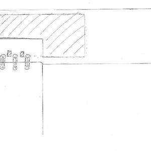

  9. G
    Worktop Joint near sink...again.
    I have managed to convince her that round the other way away from the join is the only sensible option.
  10. G
    Sorry I didn't make that clear, it's the draining board in the corner. The sink itself is in the same place it always has been.
  11. G
    Hi all, Having a new kitchen delivered on Wednesday and hopefully getting a joiner in on Friday to cut my worktops. However the other half insists we turn the sink around to what it is currently putting the draining board in the corner and this is throwing up a few problems like having to...
