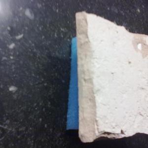

    Just about to embark on tiling a large splashback in the newly built kitchen onto plasterboard. the tiles are hand made moroccan 10cm by 10cm. The backs of the tiles are uneven and when face down slope to the middle, like a pyramid (will attach pictures). Should I use large spacers...
