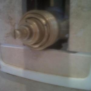

    Mixer shower not hot, cartridge or not??
    After reading more threads my update is: Cannot remove the cartridge and I am conviced this must be a plain mixer? :? I have now bit the bullet and checked the hot inlet filter, yep there was some limescale and crap, cleaned it out ,proved hot water through it, which should clear any...
  6. H
    Help!Wasted another few hours on this now, I cannot remove the thermostatic cartridge. Found installation instructions on Showerforce website ' remove black plastic ring and unscrew cartridge'. BS, I cant shift it! I am now thinking blocked filter in the hot pipe, that will be fun as the...
  7. H
    Yes it is, sorry for the delay been offline, BT prob. I think i have managed to turn the cartridge/valve so that the hot water inlet is now blocked as all I get is cold water. I dont actually know how I did this, other than removing circlip and turning the dial until it went loose, now you...
  8. H
    Evening , could anybody point me in the right direction of how to resolve a cold mixer shower. Its Showerforce kit, I have 2 in the house, 1 is never used and is red hot works as it should and the other is used every day by 3 people and runs warm only, or did till I messed about with it and...
