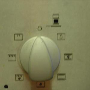

    Indesit Cooker Ser' No,FIDM201X
    Hi, just to get this up to top, so it doesn't get forgotten.
    Hello Again, I can see 4 screws inside oven, there is also a light and a Sensor Phial clipped on the top LH side. You any idea of what the Part no is I should order. I imagine I could thread sensor phial back through entry hole in back plate. I really need the part I need in my hot little hand...
    Thanks for reply, According to my users handbook there is no rear heat Element. The Fan does operate on Switch Position 4( used for de-frost) again according to book.
  12. H
    The main oven switch when used on Position 2 brought on LIGHT,FAN,HEAT. Recently it stopped doing this (after tripping MCB) Now only get LIGHT,and FAN, no heat. Turn to Position 3 and as intended Get HEAT,LIGHT.. I obtained new Multi position Switch from makers and it made no difference. There...
