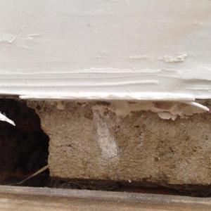

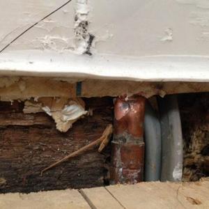

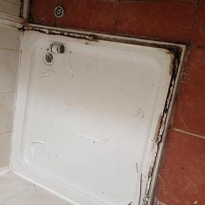

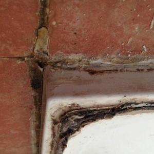

    Good morning Ok so my old shower enclosure and tray are out. The old tray was 760mm x 760mm x 55mm and was recessed into the plaster board wall and then tiled down to it. A few questions. 1. Do I have to tile down to and recess the shower tray or can I leave the tiles on the wall and...

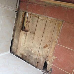

    Our house is like the house that jack build corners cut every where - I am now trying to remove the old shower tray but not getting very far pictures below (They are upside down not sure why) It seems to be cemented to the floor! Any ideas Thanks in advance Ian Shower...
