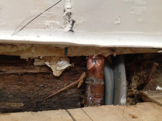

Ok so my old shower enclosure and tray are out.
The old tray was 760mm x 760mm x 55mm and was recessed into the plaster board wall and then tiled down to it.
A few questions.
1. Do I have to tile down to and recess the shower tray or can I leave the tiles on the wall and install a bigger tray maybe 90mm - then seal it directly onto the tiles?
2. If number 1 isn't possible and I buy another 55mm tray I've a couple of concerns.
A. The copper pipe shown in the picture looks slightly crushed where the previous owner and forced the tray in - opinions?

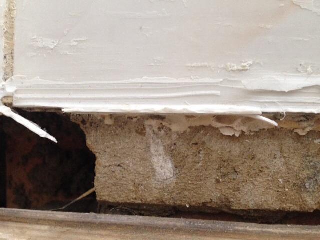

B. also on the far wall also in the pictures it looks like the concrete so not sure how they managed to recess the tray.

Copper pipe in recess looks slightly crushed
recess in wall with what looks like cement in the recess?

You can but if you don`t tile over tray, and you fit directly onto tiles and seal, the problem you may have is movement in tray breaking seal and leaking.Always best to fit tray then tile over it, then seal. You can always knock bottom layer of tiles off,fit tray then re-tile to it. ;)
Well, it`s not great, but if it`s not leaking and not affecting shower, if indeed it is the shower feed, leave it alone. If you are competent to replace, then replace it.Depends how skilled and brave you feel. :LOL:

Depends on which one you buy, more you pay, usually the better the quality. On your 3rd picture down, what you are seeing is a wall made from breeze blocks,lot of internal unsupporting walls are made like this, then plastered over.

I'd be concerned at the two cables running next to the pipework (assuming that 's what they are) - one of them look to be chaffed
