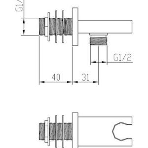

    Concealed shower point-thread too short
    You just need the right technique with the sealing tape. Loctite 55 (string stuff) is best. what is the best technique? and dont say get a plumber in :-D I also think part of the problem is the specs say 40mm exposed past back plate,when in fact there is only 32mm
    I can see the picture in my post,its in my albums if you wouldnt mind having a look,i'd appreciate it I dont think that tap extenders thread is long enough-from the backplate to end of the thread is only 40mm
    Thanks for that, the problem being the arm has a cover plate, and my concern would be that i tighten it up and it ends being on the pee when its tight? Plus i dont want to scratch the front face of the tiles when turning it round to secure if that makes sence?
    Hi everyone ive recently bought a new shower and the shower hose outlet is concealed in the wall. However, the thread is only 40mm long, and with 12mm aqua board on and then tile, it only leaves enough room to get the securing nut on, let alone a fitting. Can anyone suggest a way of extending...
