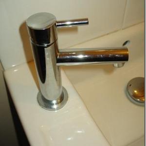

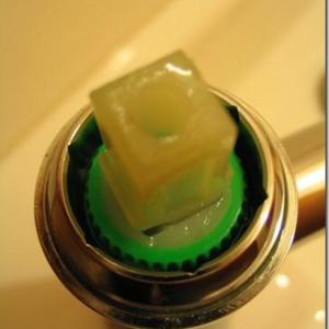

    Mini Basin Tap
    Sorry forgot to "close" this. Basically, the strap wrench idea didn't work, as the chamfer on the top didn't allow it to grip without slipping off. I made sure it was fully dry, put some elastaplast type tape around it and used a pair of grips, it loosened quite easilly in the end. Popped...

    Mini Basin Tap
    Some good ideas there, Many Thanks. I'll look for a box spanner of the right size while I'm waiting for the cartridge, but the strap wrench looks a good option as well. Cheers for that.

    Mini Basin Tap
    Partial success anyway. I haven't got the purchase receipt but, Did as suggested. They are sending me a replacement cartridge. Apparently, I need an "external box spanner" to take the old one out. The six cut outs for this are visable in the second picture. What the heck is an "external box...

    Mini Basin Tap
    I understand what your saying, but it cost me £120 about two years ago and its made by MM2, so it's not exactly a cheapo.

    Mini Basin Tap
    Hi guys, Can anyone offer me some advice on a mini basin tap. Basically, if the warm water runs, the tap movement, both on and off and towards hot or cold, starts to squeak, tighten up, then almost seize up. It has been suggested to me that it needs a new cartridge, but how can it be replaced...
