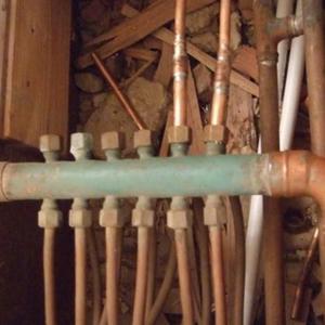

    Manifold question
    Thanks for your advise everyone. Waterworks, you were spot on. Moved the left hand pipe to the third from the left outlet (I could not get the other two on the left to undo without possibly snaping something). Worked great. Thanks again
  2. K
    Manifold question
    Sorry for seeming a bit thick, but just to make it clear are you saying - Looking at my photo move the left hand pipe (out of the two in the top right of the photo) and move it along the same side on the manifold but to the left hand end in the photo? Don't forget there is six outlets under...
  3. K
    Manifold question
    Ok thanks I will give that a try. Did I mention that out of the two pipes I connected (Top right in photo) it is the left hand pipe that is getting hot.
  4. K
    Manifold question
    Just double checked. The pipes from the radiators that the manfold feeds are coming and going from this Manifold, on looking closer some auctually come out and go back in the same side of the Manifold.
  5. K
    Manifold question
    Hi, I'm not being funny, but what difference would that make? All six outlets on that side of the Manifold were blank, I just connected it into the first two.
  6. K
    Manifold question
    Thanks for the quick reply. I do have another Manifold but this is servicing other radiators. I'm sure that this Manifold has the radiators branching off it and returning to it, I can see the pipes. So do you think the problem is I have the flow and return on the same side and the Manifold is...
  7. K
    Manifold question
    Hi, My central heating is is feed from a 22mm loop that has 10mm manifolds that branch off to the radiators. I had a heated towel rail that had an electric element in it. I have taken the element out and connected the towel rail to the manifold. Does it matter where the flow and return from...
