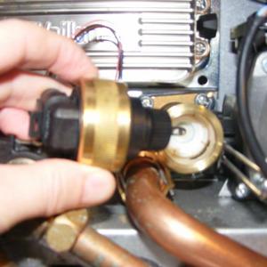

    vaillant ecotec pro 28 replacement parts
    yea got a brass nut, it comes off easyenough and i have tried "adjusting" the diverter but no joy, (got hat water now but no heat) got to get a part asap.
    Hi everyone, First my shower now my boiler !!! can any one recommend a supplier for a diverter valve for my ecotec 28 ? I have had an engineer in and he tested the diverter, it works manually but not on the motor, he said to find one on the net and he will come back to replace, (the spindle...
