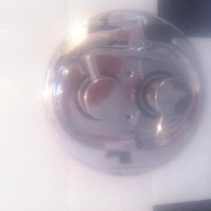

    Hi I actually sorted my shower out last night I was on the net and come across something and when I look at my shower where the hose connects to the mixer I had a flow restricter on it I took it off and it now works brill and the shower is a little more powerful thanks for all the help guys

    that is the shower thanks
  6. Untitled
  7. Shower
    Shower
    This is the shower I am having problems with

    It's a new house to me just bought it they said they did the bathroom about 5 year ago but never mentioned the problem and since I have had the house 4month it's been doing it not sure on shower model and its just a combi boiler thanks
  10. M
    My shower goes from hot to cold??
    Hi was wondering if anyone could help me I have a bristan mixer Shower in my bathroom and when I turn it on it goes hot the after about a few minutes goes cold then goes hot again any thoughts I have tried the sink and the water stays hot constant on that any ideas anyone thanks
