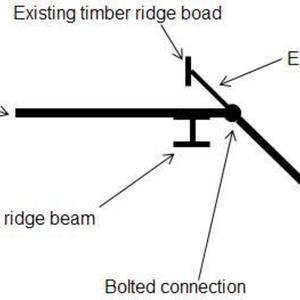

  4. Ridge Detail
    Ridge Detail
    Schematic Design of Ridge for Loft Conversion
