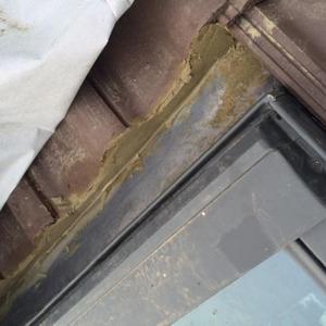

    Hi We had our roof retiled with Centurion tiles and only the Veluxes were lifted to 15 degrees. The roofers had to make their own lead work around them and now there is ingress of water between tiles and top of the windows. There are small bumps on each top side of the Veluxes which prevents...
