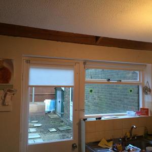

    External Wall Lintel Blockwork
    The drawings by SE listed that lintel. Building Control are via the window company. Can you elaborate please? Thanks

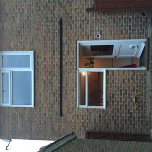

    Hi guys, Just a quick question. Having a window firm open up my kitchen window to French doors. They have left for night and infill of Catnic CX70/100 3300 is a lot patchwork. Will this be a problem as the house falling down would totally ruin Christmas!! I've attached pics and the...

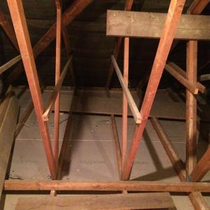

    Replacing Lintel with Larger Void - 3metres
    Thanks I can get away with standard catnic with no padstones just 150mm each end. Question... how do you install th lintel if it has a lip 1 block course up... as the picture shows there is a wooden joist tight against inner skin Thanks

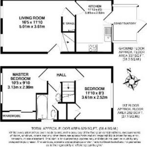

    Hey Guys, Please can someone help me with lintel replacement advice. I've read varied guides... I am replacing my rear window & door with double window & double doors. I've read you can span 3m without Building Reg or SE Drawings. Standard Catnic. What is required for Padstones I have...
