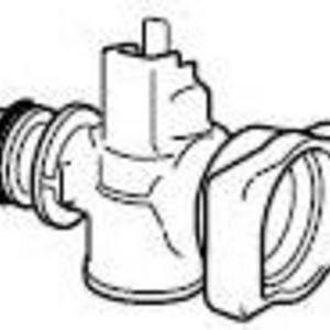

    Glow worm 24cxi leaking water
    I give up. I can't undo the brass nut above the cold water inlet valve, it just won't budge and I'm worried about damaging the pipes because they are moving under the force of me trying to turn the nut. At least I tried! Thanks for all your help.

    A couple of years ago the internal filling valve on my Glow worm 24cxi had stuck and I fixed it myself (with help from here :) ). Now I've got a new problem - a leak, mainly dripping off the bottom of DCW isolation valve. It appears to be coming from around the back of the securing clip...
