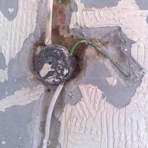

    Low resistance Neutral to Earth on existing wiring
    Hi, Spent most of today fitting some new sockets in what will be a small kitchen and struggling to persuade at least some of the existing plaster to remain on the wall! :x Adding a new circuit to an existing MK fuseboard which provides power to existing sockets, lights and doorbell and...
