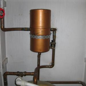

  7. P
    Help identifying this please!!
    Hi I have recently moved house and have come across this in the airing cupboard! www.diynot.com/network/pjs2388/albums/ Can anybody identify it for me?!! It is a small copper cylinder which is fixed to the wall above the hot water cylinder. It has three copper pipes connected...
