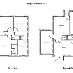

    Foundations conundrum
    Full plans = 3x price of building notice, or something like £700 vs about £250 (from memory) for building notice. So easy choice really, submit a building notice and then just agree stuff step by step with the BCO. Apart from him being a complete sadist and wanting me to dig 2m footings it...
  6. R
    Just in case anyone looks at this thread in future, I thought I'd let you know that I have agreed with the BCO to lintel over the chimney foundation, pocketed 100mm into the house wall. To be honest, based on ground conditions I think its a bit of a waste of time since I had to dig through 2ft...
  7. R
    Hmm, a lintel over the chimney foundation is an interesting idea. However I do foresee some installation issues, since being below DPC I imagine that the cavity of the existing wall has been filled with concrete. Would you be proposing to support it only on the 100mm external leaf? BTW yes...
  8. R
    Wavetrain, option D is out anyway - I have filled three 6-yard skips so far so I don't have anything to fill the hole with! :D Jeds, thanks for the reply, could you explain what you mean by underpinning? Do you mean installing a pile and a cantiliver beam of some kind under the chimney...
  9. R
    Thanks, it's another option! Though the work is being done under a building notice (rather than full plans) so not sure how enthusiastic he will be about providing advice (rather than telling me to hire a structural engineer).....?
    Advice on digging extension foundations needed, please! Sorry for the long post but I wanted to try to be clear. I'm building a 2-story extension to the side of my house, as shown in the plans below. The extension is marked "dining room". Note how the end of the extension near the living room...
