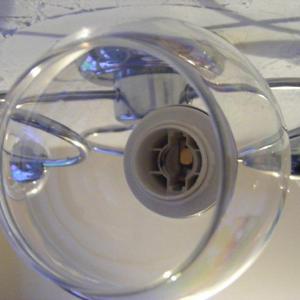

    NEXT Lighting Problems...
    Here you go...these are the 2 that blew, the 3rd has no scorch marks inside.
    Here's what I am on about...
