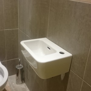

    Mounting a sink on a tiles wall.
    Hi, Quick question to see what people do generally when fitting a wall mounted sink to a tiled wall. The tiles aren't perfectly flat of course so what do most people put between the basin and tiles to take up the unevenness? I wouldn't be confident that silicon would spread the load across the...
