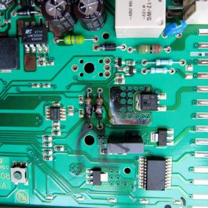

    New Element for a Whirlpool ADG7560 Dishwasher
    Got a new pcb from an ebay seller. Fitted the new part and the machine sprung into life. Unfortuantely it died after about 30 seconds. I removed the new PCB for inspection and it has blown in the same place! :-( I think enough is enough now and I've sunk enough money into buying a new...
    Zipper, you truely know your stuff. Thanks to your encouragement I went back and got the thing out. You were bang on, the PCB is totally blown. See Pic : I'll send you a PM. Much appreciated. Scott.

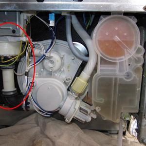

    Hi, I can see from other posts in this forum that the element can be hard to find on this appliance. True to form I cannot see anything that looks like the heating elements shown on line. As this is an integrated appliance I have not managed to remove the dishwasher so I am trying to do...
