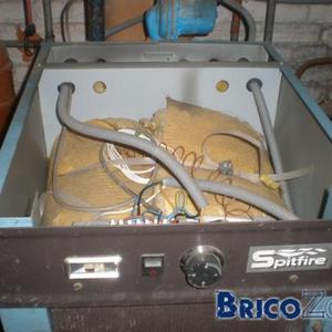

    :oops: wel ... i have just returned to my Old spitfire boiler (25 years old Belgium made boiler) and the wires are conected to the boiler not to the circulators. here a picture of the same boiler as mine ( this have only 1 ciculator pump hive got 2)
  8. S
    Just try to connect a Honeywell BDR 91 to replace a CM907 i
    can you please , explain why a external power source would be bad? if the 2 wires (the Bue and the Brown) comming from the boiler ar only a switch i s n it normal i cant give power to the BDR91? :(
  9. S
    thanks to matt1e :wink: and Google translate i just need to wires N and L to a power source of 230V. ok, i suppose the first L on the BDR91? you have :" N L L A B C wil try tomorow Thanks

    if I understand what your tryng to explain to me is, i have to use a external power source with 1 live and 1 neutral and ad it to mi switches 1neutral ( the blue one) and 1 live (the Brownthe l one),and i can not use these 2 ( the Brown the L and the blu the N) to give power to the BDR91? in...

    [/url] if I Ask here about it its because it is already down with Honeywell uk who tels me to "You haven’t wired the BDR91 correctly on your CM907 the wires were in A and B these have to go into A and B in the BDR91 plus you have to connect a Neutral to N and a Permanent Live to L so in...
  15. S
    Yes what this configuration? of course this is what you see on the wall ( of course the Live 230V an the N neutral comes from the boiler) if this was question 2 strangly if you look at the picture of the Cmt907A it worked with this twoo wires...
