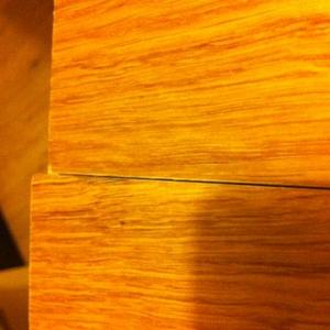

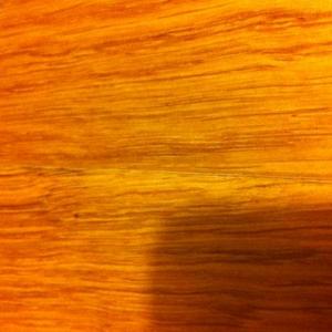

    Solid oak click system - gaps between boards
    Over the weekend I had a look at other solid oak flooring with "click" installation in couple of stores selling floors. Most of them had the same gap between boards when joined as I mentioned in my original post. The only one model which didn't have the gap was found in B&Q. So although I'm...
  10. S
    Hello, I've recently got several flooring samples sent to me. The floor which I like the most is solid oak 120mm width x 18mm thickness. It is of click installation type. But I noticed the following - if I join 2 planks together there is no "click" and the join is not tight. Otherwise...
