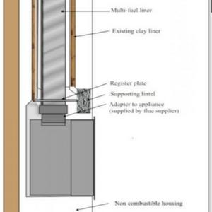

    flue line unbroken through register plate to inset stove
    Thanks muggles Here are the instructons, it shows flexi liner direct to stove. 904 is expensive, yet has a longer life, I have read that some 904's can be lower quality than 316, how does one check and do you have a link to a good flexible flue liner supplier, I am providing the...
    Hi Muggles Thanks for your kind reply, HETAS, of course not thats why I am asking, I want to make sure the recommendations made to me are correct so I can get the right person for the job. Yes Register plate as the old flue is completely open to the cavity where the stove is (uniq23)...
    Hi All I am just prepping an inset stove installation and looking at options available. Q1. Can a new flue liner in an existing chimney pass through the register plate without cutting and attaching it to the plate and connect directly to the inset stove ( I plan to backfill the void...
