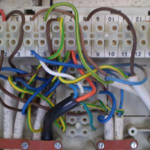

    acl programmer
    sorry orange in 7 grey in 8, typo

    acl programmer
    It is connected to a separate connector block effectively used as 2, I think. We always thought when this was installed that it looked a bit weird, but it worked fine for 14 years.

    acl programmer
    Ok here we go: Boiler br=6, bl= seperate connector block effectively 2 gy= ; ; ; 3 Frost stat gy=5 br=2 bl= ; ; ; 2 cyl stat bl=8 gy=7 br=6 MPV orange=8 gy= ; ...

  9. T
    acl programmer
    Here is a picture of the wiring center. The original installer used the vertical connector blocks as terminal 2 and 3, the only deviation from a standard fitment I can see is the addition of a frost stat.

  12. T
    acl programmer
    OK, wiring configuration is as follows: MPV white=5, green=8, orange=7, blue=2 and gren'yellow=3, cylindersat: blue=(s)8, Brown=(c)6, Green/yellow=(h)7, as per lifestyle wiring diagram. Its quite possible its something I've wired incorrectly, question is what, I replaced each wire one at a time...
  13. T
    acl programmer
    OK thanks guys for your continuing help, definitely set to P and new MPV fitted, system was working before it tripped the earth switch in the mains fuse box. Dripping MPV replaced as was cylinder stat and new programmer. It seems as though terminal one is supplying the juice to the boiler to...
  14. T
    acl programmer
    OK, thanks Boilerman2, any ideas why this terminal is giving live all the time?
  15. T
    acl programmer
    Can anyone tell me if terminal 1 of an acl LP522 should be live regardless of whether it is set to 'on' or 'off'. Currently I have HW on all the time. This a new programmer, thanks.
