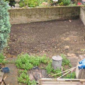

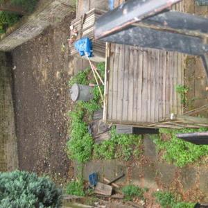

    paving slabs drainage,
    bottom of garden, no border, surrounded by garden wall, fall back towards house which is 15 metres away. paving slabs, 600 x600, substrate mot class 1, then sharp sand and cement, close joints filled with kiln dried sand. my inside leg measurement is........
    i am having a patio laid at the bottom of the garden nowhere near the house, the area is 6 x 5 metre squared, should i put some sort of drainage in. i am having a slight fall put on it.
