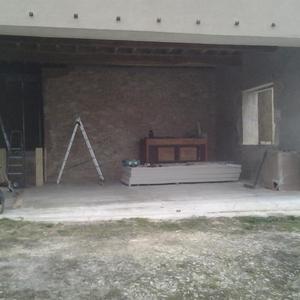

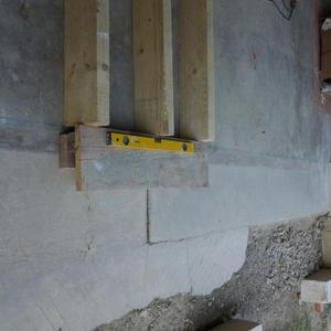

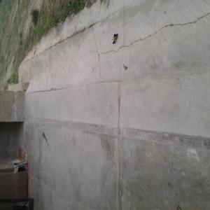

    raising floor.
    Hi Ree Iv uploaded 2 images So the joist on the inside will take the finished floor, then if you can imagine the blank of wood butting up to the joists will be the slab, then the yellow spirt level will be the track that takes the doors, im inserting rods into the exsiting concrete just so it...
  2. W
    raising floor.
    Hi ree Inside I will be laying joists, then laying solid oak, insulation between the joists obviously. The joists will seat 35mm above the slab this way the 20mm finish oak floor will butt up to the sliding doors, ie no lip. Ill take a photo and upload so you can see exactly what im trying to...
  3. W
    raising floor.
    Thanks noseall, in a way its what im doing, im laying an independent slab, which will be 110mm thick it will be reinforced, the foundation its sitting on is the exsiting concrete floor, I will drill down into the exsiting slab and put still rods into the slab about 100mm deep these rods will be...
  4. W
    raising floor.
    Thankyou very much. Yes the threshold of the whole 6 meter width dose slightly fall right to left, my new slab will be straight, then as you say, once iv laid concrete for the track ill do a slight fall going away from the house, im on a very modest budget, so doing most of the work myself. Iv...
  5. W
    raising floor.
    Hi iv uploaded a couple of pics for you to see, in my album.
  6. W
    raising floor.
    Hi Yes its an opening of the building to the outside garden The exsiting floor is concrete, ill try to upload a pic but not sure how
  7. W
    raising floor.
    Hi all. Im having 2.8 meter high x 6 meter wide aliminum sliding doors fitted. At the moment the opening hight is 2.91high. Basically I need to raise the area were the bottom track will seat by 110mm, I will take the finished level out into the gardem about a meter, So area to fill will be...
